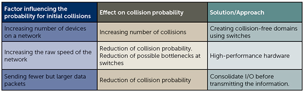

No such formula can be provided for an Ethernet system where it is possible that two nodes on the same network start to transmit data at the same time. The probability of such an initial data collision is influenced by a number of factors. A real-life example of a probabilistic system frequently encountered is that of a person taking his car to the office. On a good day with light traffic this person will most likely be faster than the person walking and taking the train. During heavy traffic hours the situation is different. Now the total travel time depends on factors like traffic density, weather, and accidents along the way. The best one can do is to calculate a minimum time based on distance and maximum legal speed, but as everybody living in Los Angeles, Chicago, or Boston knows, it is not possible to predict the maximum travel time.
Collision management
To handle data retransmissions Ethernet uses CSMA/CD (Carrier Sense Multiple Access/Collision Detection) where, after an initial collision, both parties “sense” the data collision and then pause for a random time period known as backoff delay before attempting to retransmit their information. And since there is inherently nothing that would keep the two from selecting the same backoff delay, there is a certain likelihood (in fact it is 50%) that the second attempt could again result in a data collision. Fortunately, Ethernet uses a method by which the backoff delay is increased after each collision, eventually allowing both parties to send their information with near certainty. Unfortunately, the message delay between sender and receiver has to increase significantly. This procedure is called truncated binary exponential backoff, where the number of random time slots increases as 2n for the nth collision. On Ethernet, n is truncated at 10 resulting in a maximum number of 1024 possible intervals and the number of retry attempts is limited to 16. In case 16 retries is not sufficient internal error messages are generated.
As a consequence of these collisions and the random nature of the transmission retries, a question like “What is the time one has to wait until a message is transmitted with certainty?” cannot be answered. The only question one can address is “What is the likelihood that my message will make it in a certain time?” Clearly this is not satisfactory and, in the past, increasing the raw speed of Ethernet to Gbit and 10 Gbit versions was an obvious way to address the issues. The biggest drawback of this brute force method is the increase in hardware and cabling cost. But even with overwhelming raw speed, professionals agree that Ethernet must be used differently in automation environments.

Why is combining Ethernet with a low-level I/O solution the way of the future? Low-level deterministic I/O solutions consolidate all machine I/Os at a gateway to Ethernet. Thus, all this information fits nicely into a single Ethernet data packet, reducing the network loading considerably. Depending on the specific low-level I/O solution teamed up with Ethernet, other planning, installation, and maintenance advantages benefits can be realized.
Because a single gateway may handle hundreds of field I/O, even large installations typically need only a few of them, making the additional cost of integrating a switch necessary to make Ethernet collision free a non-issue.
network-io-chart
