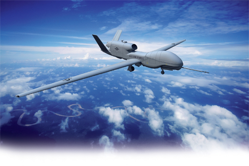

Small and miniature aircraft, also known as UAVs (unmanned aerial vehicles), require reliable propulsion systems in order to achieve extended flight times with minimal quantities of fuel. Previously, the only option available for fuel delivery to the engine was a carburetor.
The latter, however, is not able to provide an optimum fuel mix for all of the various phases of flight. A newly developed miniaturized electronic fuel injection (EFI) system created especially for small combustion engines provides the benefits of fuel injection, long enjoyed in larger engines, for small UAVs. This system combines reduced consumption and considerably increased reliability. Microdrives are used to power the fuel pump to ensure the correct pressure in the fuel system.
US-Air-Force-UAV
Considerably cheaper to purchase and maintain than manned flights, UAVs are compact and need small internal combustion engines for power; yet, they are fitted with carburetors for fuel delivery purposes. An EFI system, developed by Currawong Engineering Pty Ltd from Kingston, Tasmania, Australia, delivers an optimum fuel mix at all stages of flight, even for miniature aircraft. The fuel, which is under pressure within the system, is injected into the intake manifold using special fuel injectors; while, the fuel/air ratio is electronically controlled by a multi function electronic control unit (ECU). A low-weight DCMicromotor ensures consistent fuel pressure, regardless of height, fuel levels and flight maneuvers. Auxiliary energy is required to build up the necessary fuel pressure.

    Um… isn’t that a picture of a turbine based UAV? Anyone want to collaborate with me on a redundant ECU port injected Wankel based UAV power plant?
