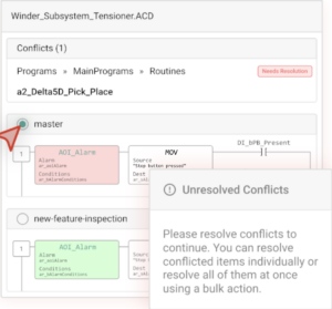

Git-based version control means changes to all projects are tracked with context. Using the Copia Industrial DevOps platform, the files are stored locally and in a central repository for developer collaboration. Copia renders the difference between versions graphically and changes are highlighted to easily see what’s been added or edited.

Copia Automation interface.
Copia renders ladder logic, function block diagram, and structured text. All changes are clearly highlighted for quick and thorough code review. Source: Copia
