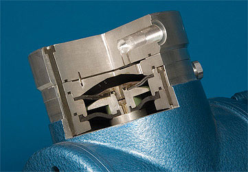

Double diaphragm pump uses a working diaphragm, top, to provide pumping action; and a safety diaphragm, bottom, to guard against leakage.

Double diaphragm is another configuration variation, pairing a “safety” diaphragm with a “working” diaphragm to safeguard applications where hazardous, toxic, or otherwise harmful (or valuable) media must be transferred. Such applications raise the bar on the demands for gas tightness and leakage prevention and have been commonly engaged for decades to monitor emissions at nuclear power plants.
Together with additional sealing rings, a double diaphragm arrangement enhances gas tightness with leak rates as low as < 6 x 10-6 mbar l/s. (In very rare cases, should the working diaphragm become damaged, the pumped medium will not escape but will be captured in the intermediate space between the two diaphragms.) The “safety” diaphragm is subject only to low mechanical and thermal loads during pump operation; the “working” diaphragm is elastically distorted and warmed by the compression process.
A rupture of the working diaphragm will easily be detected through a sudden and dramatic drop in the pump’s pumping or compression capacity. A sensor can be fitted to monitor the intermediate area between the working diaphragm and safety diaphragm to detect any damage to the working diaphragm. Suitable pressure and gas sensors can be specified for this task.
