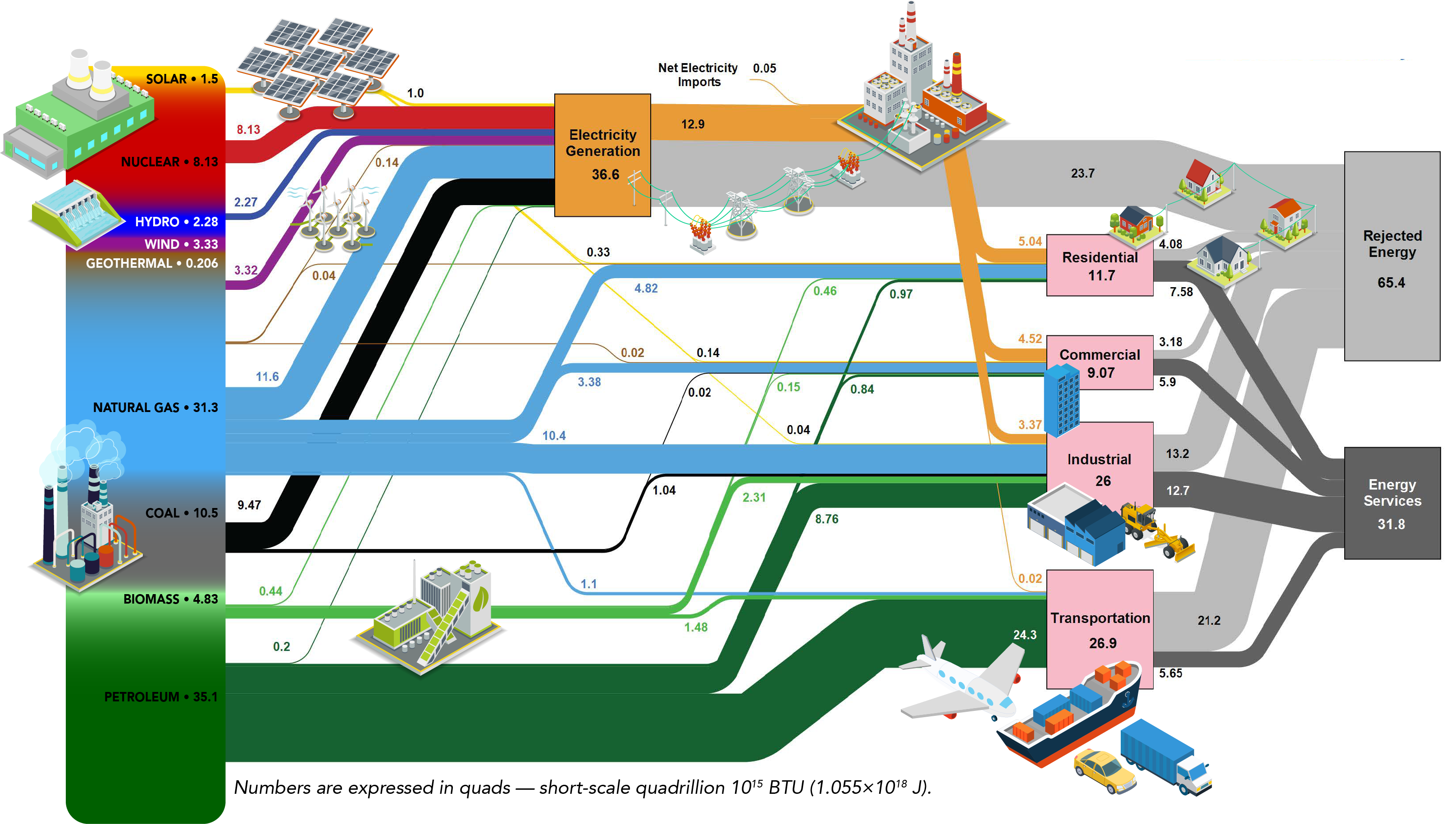

Shown here is a Sankey representing sources, uses, and wastes of energy in the U.S. Values are based on data from March 2022 via the Energy Information Administration. Distributed electricity here includes retail electricity sales and none self-generated. Electricity production efficiencies here is the total delivered electricity divided by the primary energy input. End-use efficiency is about 65% for residential, 65% for commercial, 21% for transportation, and 49% for industrial (with the latter reflecting DOE analysis of manufacturing). Source: Lawrence Livermore National Laboratory • Department of Energy
Key is the reduction of waste heat and emissions from electric utility power plants and transmission systems (purchased power) as well as the power distribution elements, motors, drives, engines, compressors, lights, mechanical components, and other elements under an operator’s control in the plant itself.

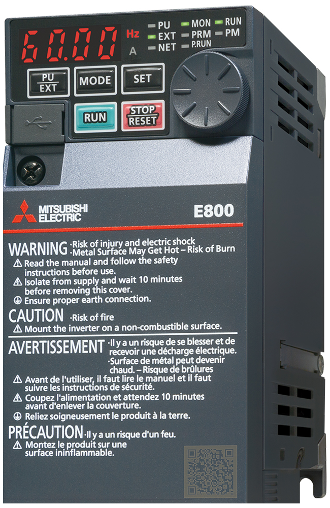

The Mitsubishi Electric FR-E800 series (with safety functionality meeting IEC 61508 standards) supports various networks such as CC-Link IE TSN — a next-generation open industrial network — and makes manufacturing smarter by integrating the world’s first corrosive-gas environment detection circuit. Ir also features the industry’s first AI-based diagnostic functions for top efficiency.
