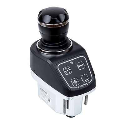

The three-axis Marex OS 3D joystick enables intuitive operation without having to coordinate the propulsion elements separately. Based on the specific situation, the captain can choose whether to use the 3D mode, which actuates the main propulsion drives and bow and stern thrusters centrally, or to control only the thruster with the joystick in thruster mode.

The Aventics Marex OS 3D joystick facilitates intuitive operation
This convenient, secure maneuvering at the tap of a finger is thanks to the proven Aventics control concept. The individual components of the Marex OS 3D can be combined based on the application and desired equipment. Starting with the joystick in a modern, ergonomic design through to the preassembled cables to connect modules and the main computer via CAN bus, the Marine Technology experts at Emerson have perfectly matched all technical elements to one another.

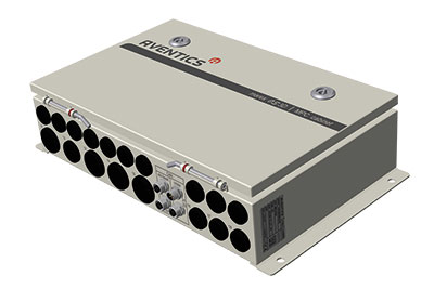

The heart of the system is vector controlled by means of a marine propulsion controller. The MPC 3D processes the commands received by the joystick, calculating vectors that are required to control the main propulsion and thruster. In combination with an electronic compass, this technology makes maneuvering much easier, even when facing strong side winds or currents. Such adverse environmental conditions are no problem for the system thanks to its automatic heading compensation function, enabling effortless lateral or diagonal movements on the spot using the joystick.

The AVENTICS™ MPC 3D controller processes the commands received by the joystick.
