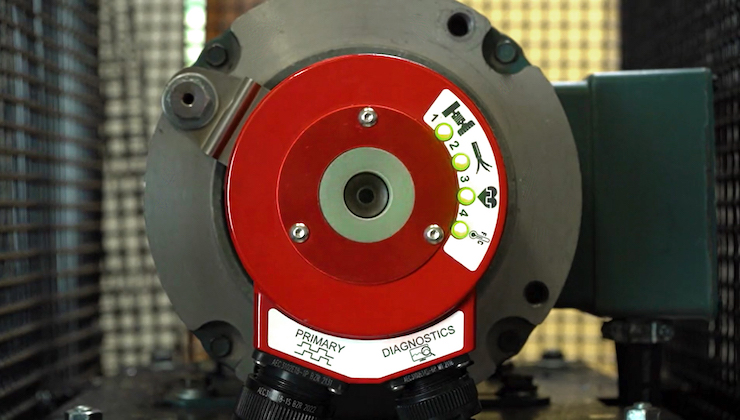

Cachro: Due to an aging workforce, limited availability of skilled labor, and increasing production demands to run at near maximum capacity, end users demand more reliable encoder solutions that maximize uptime and provide diagnostic data for reduced troubleshooting duration. At the same time, machine builders are increasing after-market support with field technicians or multi-tier remote support to help when customers experience issues with OEM equipment. As a result, we see a need for components that offer self-diagnostic capabilities that solve these pain points and provide immediate data at the problem area to help users know what to correct rather than guessing. With this in mind, our encoder solutions, such as the HS35iQ encoder, offer visual indication of specific fault conditions and advanced fault data output, allowing end users to fix problems without guesswork and enabling more efficient remote troubleshooting for OEMs.
encoders
Encoders such as the Dynapar HS35iQ offer visual indication of specific fault conditions to reduce troubleshooting time.
