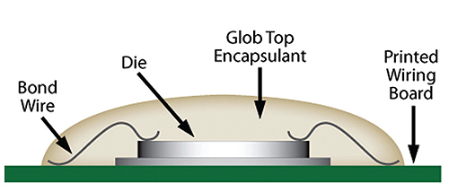

Glob top encapsulants
Closely related to conformal coatings, epoxy based “glob top” encapsulants protect and support bare die and their wire bonds in chip-on-board (COB) assemblies. Bare die mounting to a PCB or substrate is common in space restricted electronic assemblies, such as handheld consumer and industrial devices. Glob top encapsulants protect vulnerable chips and wire bonds from contaminants while providing the mechanical support necessary to prevent stress related failures during handling and assembly. Although they exhibit many of the same post cure properties as conformal coatings, glob tops provide a thicker, more resilient barrier than do coatings, making them the preferred choice for delicate bare chip devices.
Epoxy-based-glob-top-encapsulants
Epoxy based “glob top” encapsulants protect and support bare die and wire bonds in chip-on-board (COB) assemblies while providing the mechanical support necessary to prevent stress related failures during handling and assembly. Glob tops provide a thicker, more resilient barrier than do coatings, making them the preferred choice for delicate bare chip devices.
Specifically formulated to be thixotropic, glob tops flow smoothly in response to stress applied during application, but rapidly increase in viscosity. This allows them to easily cover the chip and fill narrow gaps between wires without damaging delicate parts, while preventing them from flowing beyond the desired area. The physical properties of epoxy based glob tops are carefully controlled to suit the COB application. Glob tops are electrically insulative, resistant to moisture and chemicals, and devoid of ionic impurities that may react with moisture to cause corrosion. They are free of solvents that may lead to bubble formation, which can result in penetration by moisture or contaminants. To minimize thermal stress, glob tops contain silica or alumina filler material, which reduces the CTE of the epoxy compound so that it is closer to that of silicon and gold.

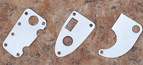

Films and preforms
Solid epoxy adhesives, sold as small sheets of film or custom cut preforms, offer uniform bond lines with minimal squeeze out — benefits that are critical to certain applications in the electronic industry. When bonding heat sinks and other large surfaces, solid films are preferred because it is difficult to achieve a uniform bond line over a large surface area using liquid adhesives. For applications in which squeeze out may pose a problem, such as lid sealing or bonding substrates located near a channel through which ink or another liquid must flow, films and preforms are a better choice than liquid adhesives.
epoxy-films
Epoxy films and preforms are ideally suited for applications requiring uniform bond lines and minimal squeeze out.
Epoxy films are manufactured as premixed, frozen adhesive films or as partially cured B staged adhesive films. While they differ in terms of storage, working life, and cure schedules, both types of films can be engineered to offer a variety of physical properties to meet specific application needs. Additionally, B staged adhesives can be applied in one stage of the manufacturing process and cured to completion in a later stage — even at a different location — presenting opportunities for process efficiencies.
