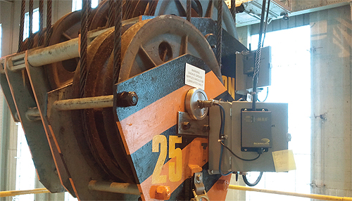

mine-lift-equipment
Complex systems, such as mine lift equipment, construction cranes, industrial tanks, grain silos, and locomotives, which may have lacked weight or force sensing capability in the past, are being upgraded to include load pins, load cells, and tension cells.
“Complex systems such as mine lift equipment, construction cranes, industrial tanks, grain silos, and locomotives – which may have lacked weight or force sensing capability in the past – are being upgraded to include load pins, load cells, and tension cells,” said Riley Phillips, mechanical designer at Massload, a Saskatoon, Canada-based manufacturer of quality weighing systems. “These sophisticated weight and force sensing devices can help to maximize production load efficiency while offering some of the enhanced safety features that are increasingly required by regulation, such as automatic shutdown if a load exceeds capacity.”

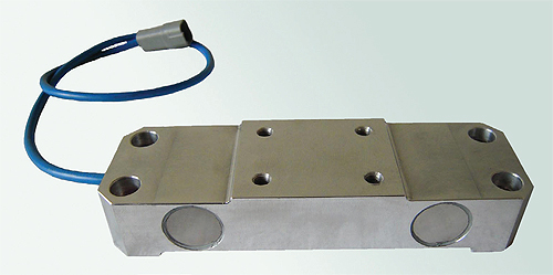

load-cell
A load cell is a transducer that changes force into a measurable electrical output.
The basics
A load cell is a transducer that changes force into a measurable electrical output. There are many varieties of load cells, of which strain gauge-based varieties are the most common.
Load cells can range from versatile single-ended shear beam, which can be used in weighing applications such as blenders, hoppers, and floor scales, to double-ended shear beam, which can be used in applications such as tank weighing and large capacity platforms.

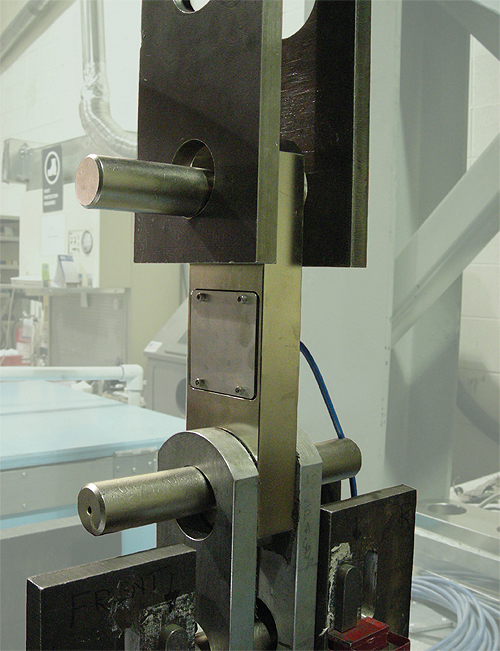

tension-links
Tension links are often used in lifting, pulling, and winching applications such as for cranes, line wire tension, and man safety cages in mines.
