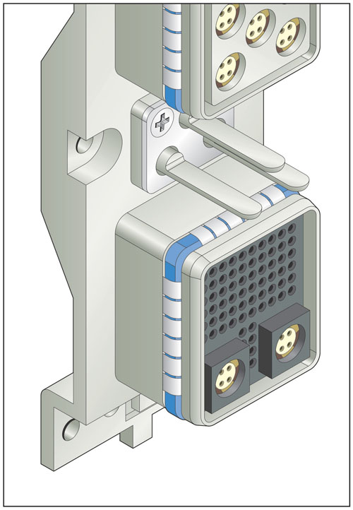

Failure is not an option in aircraft connectors. Illustration courtesy of Cleaver Brinkerhoff.
Wear and tear — Like the example above, repeated connection and disconnection of a connector can cause the metal on the contacts to wear and corrode if exposed to water, dust, dirt and other harsh elements. As a result, the mating pins may not properly engage when inserted into the connector shell. Always choose connectors rated for the required mating cycles you will need.
