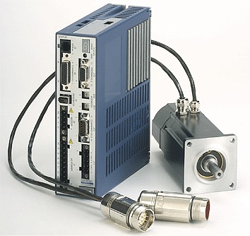

To find out if this approach will work for you, analyze each basic motion system component that you usually deal with, including controllers, motors, and servo drives. Because the controller is the heart of the system, it is usually the component selected first. Some of the basic factors to consider include the controller’s ability to integrate a human machine interface (HMI) and input/output (I/O) channels, connect to higher level controllers, close servo loops, and write application programs with ease. Also, consider whether you need central or distributed control, the type of programming language the controller uses, how that language is executed, and finally – the users’ preferences.
Danaher’s flexible drives work with its “eXMP” controller to handle a special motion bus called “SynqNet.” Unlike an analog system, it updates each axis in 250 µs, which ensures that its operating parameters continually meet specifications. In addition, motor feedback information can be sent through the bus, which replaces a separate feedback cable.

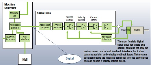

Unlike drives of just a few years ago, modern digital servo drives are capable of far more than simply being configured to fit the control scheme of the machine and perform basic functions. They substantially reduce the time needed to get the machine on line and significantly lower total machine expenses. The pathways laid out to achieve these benefits are wide and varied. They include selecting operating modes, master/slave configurations, and motion indexing and I/O functions. They also consider brake controls, tuning, system errors, network interfaces, information transfer, setup time, and feedback devices.
Operating Modes:
A flexible digital drive has various possible architectures, from a simple current loop with a power amplifier, to a single unit that closes all servo loops, controls I/O, and handles some or all of the machine’s controls. In some applications that use a central controller, the position and velocity loops are closed outside of the drive to tighten the synchronization between two or more motors. Machine tools, robots, and electronic assembly machines are examples that need this degree of coordination between axes to obtain micron-level positioning for smooth surface finishes on machined parts.
Modern, configurable, digital servo drives can handle many of the functions that were traditionally relegated to the machine controller. The drive is configured through the GUI, which can be done with a setup wizard in half the time normally needed.
