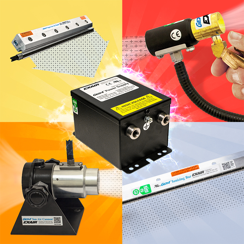

EXAIR’s new Gen4 two-outlet selectable voltage power supply lets engineers choose input voltages of 115 Vac or 230 Vac. Two 5-kV stainless steel output connectors can energize two static eliminators. Applications using up to two EXAIR Gen4 Super Ion Air Knives, EXAIR Ion Air Guns, EXAIR Ion Air Cannons, EXAIR Ionizing Bars, or any other EXAIR Gen4 static eliminator product can be connected to one power supply. Like all EXAIR Gen4 products, these two outlet power supplies are UL component recognized, CE and RoHS compliant.
The Gen4 two-outlet selectable voltage power supplies also feature an electromagnetically shielded modular power supply cable which eases routing and connections. An integrated fuse on the primary protects against voltage spikes. The lighted power switch indicates operation and is field replaceable. The Gen4 Two Outlet Power Supply is housed in a durable metal enclosure (5.5″ L x 4.0″ W x 3.4″ H) that is ideal for rugged, industrial environments. Gen4 static eliminators having a bayonet-style connector can be inserted into the power supply where the electrical connection is made deep inside to prevent a shock hazard.
Gen4 static eliminator products for the power supply are all shockless and have armored high voltage cables which resists abrasion and cuts. The two outlet power supply price is $431. For more information, visit exair.co/58-g4power2.htm.
