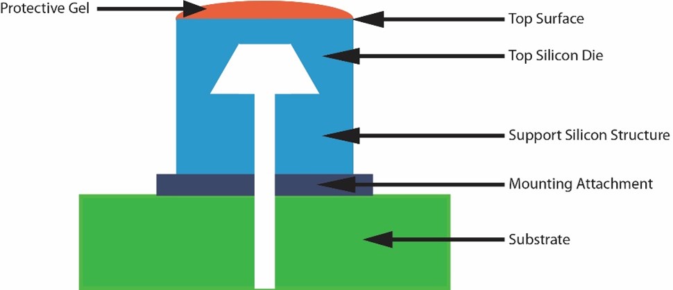

In silicon pressure sensors, a passivation layer applied near the end of the wafer manufacturing process protects implanted or diffused elements on the top surface but the diaphragm area is masked to avoid the dissimilar material interface and dampening effect (with lower response time) that would be caused by the protective glass layer. Thus, subsequent protection at the package level is frequently required, especially for harsh applications. An example of the cross-section with a protective gel is shown in Figure 1.
Figure 1. Cross-section and typical materials of plastic-packaged MEMS pressure sensors.
