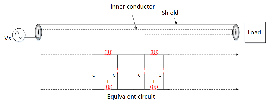

  Transmission lines such as coaxial cables appear to be simple passive components consisting simply of an inner conductor and outer conductor (or shield) (Figure 1 (top)).
Figure 1. The schematic of coaxial cable (top) does not give any hints as to its equivalent-circuit model (bottom). (Image: Circuit Design, Inc.)
In the simplistic view, it is just a conductor (wire) fully surrounded by a 360° shield for confining any electromagnetic energy radiating from the center-conductor wire while preventing outside energy from impinging on the wire. But there’s much more to the coaxial cable/transmission line situation than that.

Even though there are physically only two conductors – center wire and shield – a source or transmitter sees a cable seemingly made out of distributed inductance and capacitance, as shown in the equivalent circuit (Figure 1 (bottom)) — the coaxial cable functions as a waveguide for supporting the propagation of electromagnetic energy and confining it.
The transmission line has a characteristic impedance, usually designated as Zo. Cable characteristic impedances can have many possible values depending on the conductor dimensions, internal spacing, and dielectric properties of the spacing insulator between the cable’s inner conductor and outer shield, with 50 Ω or 75 Ω the most common values.

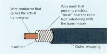

A: There’s much more behind the story of those simple-looking coaxial cables and their connectors than just a solid inner conductor with some surrounding shielding; coaxial cable is a precisely dimensioned waveguide for electromagnetic energy (Figure 2).
Figure 2. The physical construction of coaxial cable is conceptually simple, but it actually is a carefully dimensioned component built of carefully specified materials. (Image: Elsevier/Science Direct)

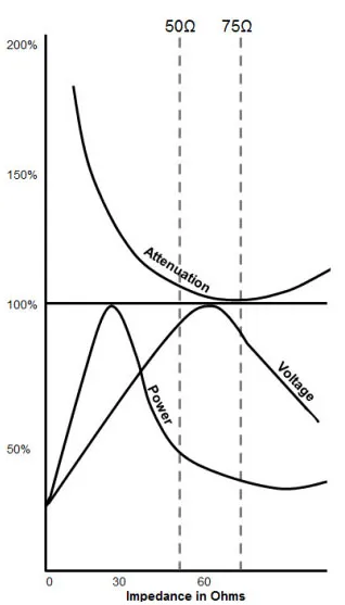

The two researchers analyzed the tradeoffs among key transmission-line parameters of attenuation, voltage rating, and power rating (Figure 3).
Figure 3. Among the key transmission-line parameters are attenuation, voltage rating, and power rating, and each has an optimum value at a different impedance. (Image: EEVblog Electronics Community Forum)
Q: What did they determine?
A:
Their analysis looked at the performance of three characteristics as a function of impedance:
  • Attenuation (loss) is largely a function of the dielectric in the cable. For the air-filled coaxial cable they analyzed, the lowest loss is at about 77 Ω, around 50 Ω for some dielectrics.
  • The voltage maximum is a function of the intensity of the electric field between the coaxial outer conductor and the inner conductor. For coaxial cable supporting RF signals in the TE10 electromagnetic-field (EM) waveguide mode, the e-field is maximum at around 60 Ω.
  • The power-handling capability is determined by the breakdown field and impedance (V2/Z); for air-filled coaxial cables operating below the TE11 mode cutoff frequency, the power transfer is at its maximum at around 30 Ω.

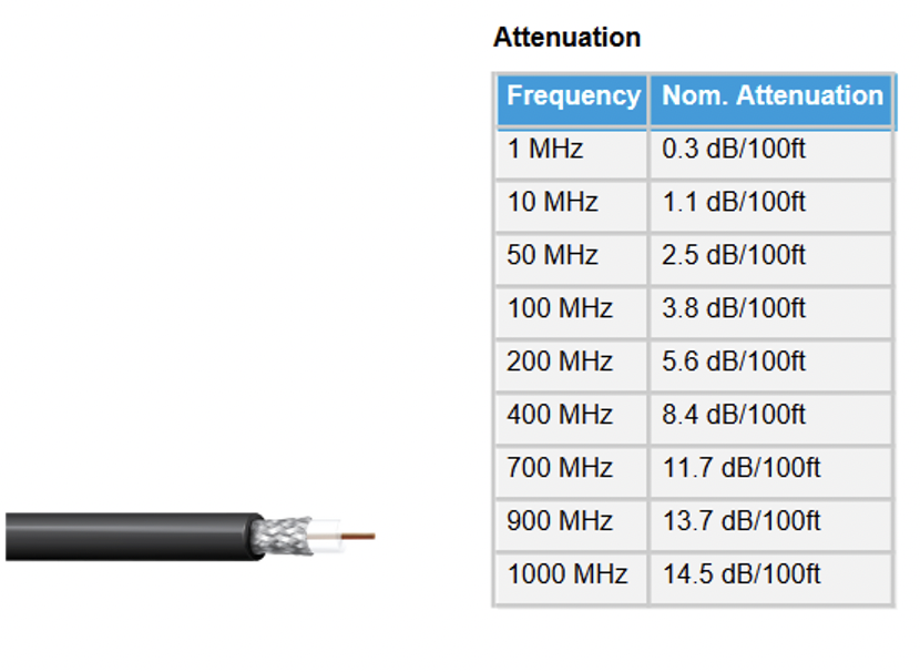

Translating electromagnetic field theory and analysis into real transmission lines is the function of coaxial cables, most of which have an “RG” designation (RG, or Radio Guide, comes from the original WWII military specification for coaxial cables).
Figure 4. This Belden RG-58 is a 50-Ω coaxial cable with a 20 AWG solid bare-copper conductor specified up to 1 GHz. (Image: Belden Corp)
Although there are well over a hundred RG-x varieties, nearly all have either a 50- or 75-Ω nominal impedance. The difference among the many versions relates to their physical size, insulation specifics, shielding type and performance, dielectric material and construction, power rating, environmental ruggedness, fire-related ratings, and other factors. The RG-X number often has a letter suffix after the “X” number to identify a specific non-impedance attribute such as a ruggedness rating.

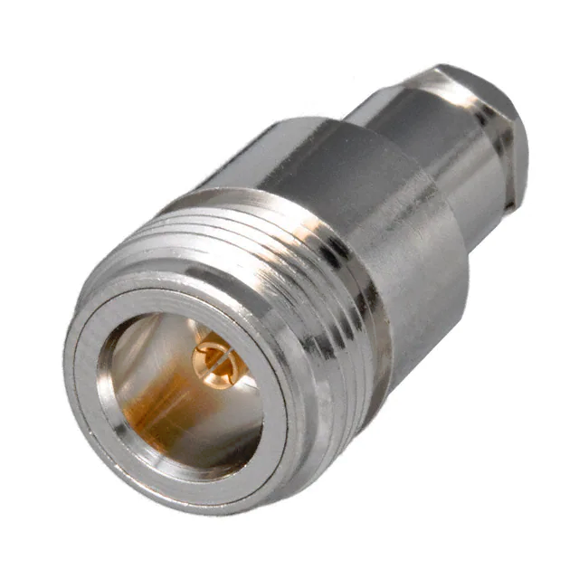

Figure 6. The Type N connector is a newer 50-ohm alternative to the PL-259 with a wider frequency bandwidth. (Image: Cinch Connectivity Solutions/BelFuse)

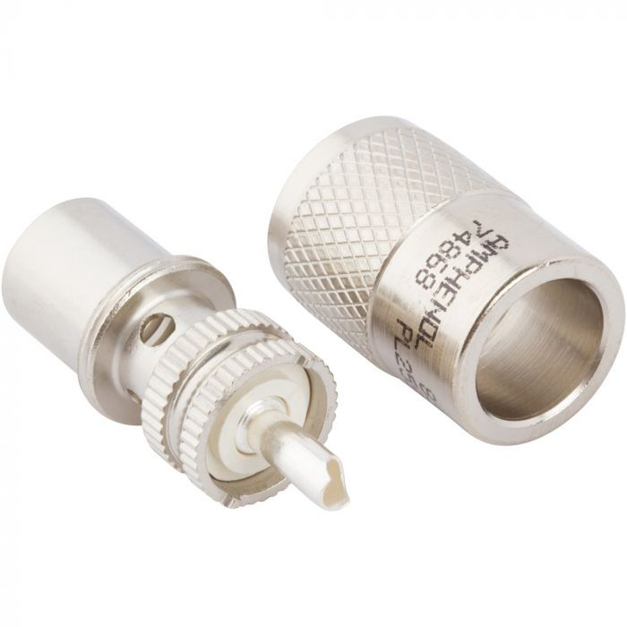

Figure 5. The PL-259 coaxial connector was one of the first widely used terminations, and it is still used. However, its frequency limitations have diminished its applicability; shown are the body and the outer shield, which goes over it. (Image: Amphenol)

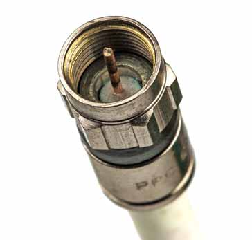

Figure 7. The Type F connector is a low-cost 75-Ω connector designed for consumer TV; it is offered in a wide range of attachment styles. (Image: Electronics Notes)

There’s more to using a coaxial cable than just the cable itself, as it needs to be terminated with a connector designed for the correct impedance and coaxial-cable size and shielding. Among the commonly used connectors for 50-Ω coaxial cable is the venerable PL-259, available in many versions from many vendors (Figure 5), and the wideband Type N (Figure 6).
Many 75-Ω systems, especially those in low-cost consumer applications, use the Type F connector (Figure 7). These are available in many versions, including push-on, thread-on, and “bayonet” retention.

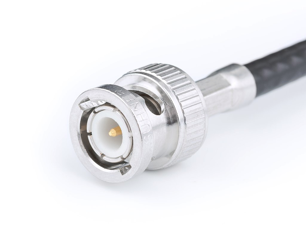

Figure 8. Developed during WWII, the BNC connector is still used and often found on test and instrumentation systems; both 50- and 75-Ω versions are available with very similar appearance but critical dimensional differences. (Image: Wikipedia)
Also, when making out the all-important bill of materials (BOM), it is critical to check the impedance value of the coaxial cable and associated connectors or any pre-cut and terminated cable being specified. It’s easy to inadvertently pick a 75-Ω coaxial cable instead of the intended 50-Ω one or vice versa. Further, connectors such as the classic BNC style (among the oldest still used) come in both 50- and 75-Ω versions, which look the same, having only slight differences in dimensions – they can even be mated with a little “pressure” (Figure 8).
