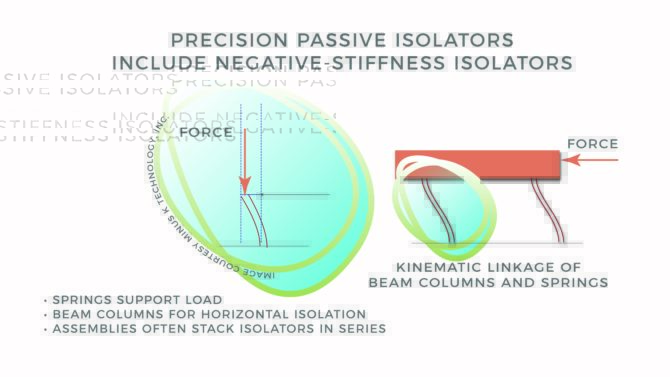

Precision passive isolators include negative-stiffness isolators, which decrease system natural frequency upon loading via a kinematic linkage of beam columns and springs … typically stacked in series for tilt, horizontal, and vertical motion.
