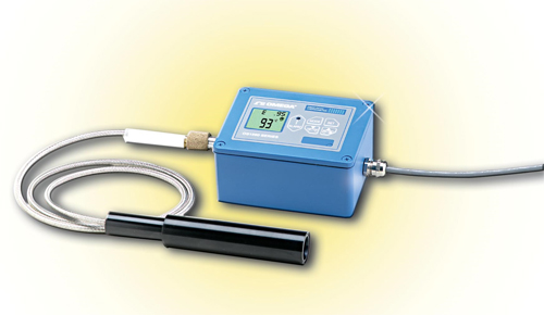

Omega’s new, low cost fiber optic infrared thermometer/transmitter features an easy to read local display and two isolated analog outputs. The dual display indicates current plus min, max, or differential temperatures. This CE marked product measures temperature ranges up to 2482 Celsius (4500 Fahrenheit) with an accuracy of 1% of reading.
Omega-infrared-thermometer_transmitter
The main electronics is in a NEMA 4 rated aluminum housing with a built-in relay, alarm LED, and a 4-position programmable keypad to adjust Emissivity (0.05 to 1.00) and high & low alarm set points. The OS1592 is well-suited for both hard-to-reach small areas and polymer bolt applications. Ideal for Semiconductor manufacturing to monitor the temperature of the wafer during electrical test and other manufacturing processes. Also ideal for metal annealing to monitor the temperature of annealing process.
