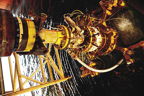

The DNV team assembled a base of operations at NASA’s Michoud facility in New Orleans. The intervention vessel Q-4000 raised the BOP stack and delivered it to a temporary enclosure there for investigation.

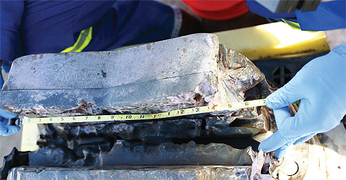

The BOP stack, together with several pieces of drill pipe, was raised from the well site and transferred to a holding facility at NASA-Michoud. The team cleaned, photographed, and cataloged the stack, disassembling where necessary to get at its inner workings.
Hydraulic fluids and metal samples were taken for analysis, the stack’s control mechanisms and their batteries, actuators, and solenoids were tested, and the casing and blind shear rams, variable bore rams, and upper and lower annular preventers were all visually inspected and 3D laser scanned.

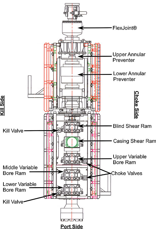

The huge BOP stack sits on the sea floor directly above the wellhead. Its two halves together are as tall as a six-story building and weigh over 400 tons. The top half, called a Lower Marine Riser Package (LMRP) contains two electronic control pods together with a pair of donut-shaped sealing devices called the Upper and Lower annular preventers. The preventers seal around the drill pipe and regulate upward fluid flow.
The lower half of the BOP stack contains a series of shear and bore ‘rams,’ and the valves and hydraulics that actuate them. Depending on the circumstances, these rams serve to ‘choke’ the well, or ‘kill’ it if necessary.

DNV’s analysis, supported by FEA data, indicates that the primary cause of failure was the BSR, or blind shear ram’s inability to cut the drill pipe and seal the wellbore. The BSR is like a big pair of scissors, with opposing blades designed to cut the drill pipe and seal its end in a last-ditch effort to kill the well. FEA clearly showed that the shear ram should have been able to do its job. The required force was in the middle of the test and calculated data range for a nominal, centered pipe model, and there was nothing out of the ordinary with the strength of the drill pipe itself. The BSR would likely have worked, except for one thing: the pipe wasn’t where it was supposed to be.
When activation of the blind shear rams occurred during ROV intervention, the annular preventers were already sealed around the drill pipe at the top of the BOP stack. The variable bore rams were sealed around its lower half. The pipe should have been in the center of the well bore, which is where the blind shear ram expected it to be. However, physical evidence from the markings on the recovered portion of the drill pipe indicated that the pipe was at the side of the wellbore instead.

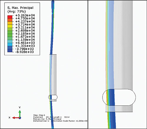

The DNV engineers postulated a reason: One of the pipe’s tool joints was positioned just below the upper annular preventer, which was closed on the drill pipe. When upward pressure became high enough due to the forces caused by the blowout, the pipe had nowhere to go and the upward forces (compression forces on the drill pipe) caused the drill pipe to buckle—pushing the pipe to the side of the wellbore. The blind shear ram tried to cut the pipe off-center, unsuccessfully. This jammed a portion of the drill pipe between the ram block faces, preventing the rams from fully closing and sealing the wellbore.

As DNV’s investigation into the proposed sequence of events deepened, FEA continued to support the team’s theories. They started with a buckling analysis to determine what the necessary load would have been to move the pipe to the edge of the casing. The FEA models indicated that the applied pressures would have been sufficient to force it out of position.

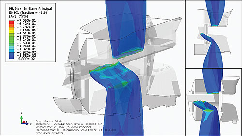

“First, using a combination of the shear damage parameters, in conjunction with the known elastic and strength values of the material, our FEA data validated the estimated pressures needed to shear the pipe under a center-load condition,” said Finneran.
Next, the engineers simulated the situation seen on the Deepwater. “Our shearing analysis showed that, with the pipe off-center, the rams would have been prevented from closing fully,” said Finneran. “This allowed flow past the blind shear rams and caused significant erosion of the blind shear ram components and wellbore.”
“We determined that, under blowout conditions of this well, it was possible for the drill pipe to buckle between the UA (Upper Annular Preventer) and U-VBR (Upper Variable Bore Ram),” said Finneran. The DNV hypothesis was supported by their off-center BSR shearing FEA model, which provided results consistent with those damaged pipe segments, as well as the erosion damage seen between the rams, wellbore, and recovered drill pipe.
