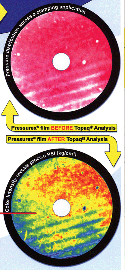

The special sensor film shows the pressure distribution and magnitude between any two contacting, mating, or impacting surfaces. For example, Pressurex is a brand name for SPI’s pressure indicating film of thin Mylar, only 4 to 8 mils thick, that contains a layer of tiny microcapsules. Force applied to the film ruptures the microcapsules and produces an instantaneous, permanent, high-resolution topographical map of pressure variations across the contact area. The color intensity of the image directly relates to the amount of applied pressure. The colors are either manually compared to a color-correlation chart or electronically scanned and quantified with optical imaging techniques for more in-depth analysis. One such technique uses an advanced pressure analysis system called Topaq, which extracts statistical data and high-resolution pseudo-color images. The advanced optical imaging analysis greatly improves the capability and value of the film. It defines the pressure distribution and magnitude in a variety of output formats. Vital statistics such as total force, average pressure, total area in square inches of contact, and standard deviation can be determined within +/-4% accuracy. Topaq can also render histograms and population statistics on user-defined regions of interest.
The pressure distribution across a bolted joint appears as a variation in color intensities to the naked eye, but under Topaq analysis, the color intensity and variation reveals the precise distribution of pressure in psi.

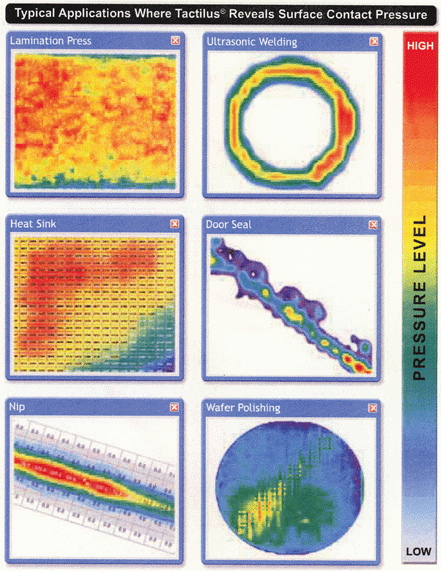

The leaded-type of pressure sensor records and interprets the pressure distribution and magnitude between two contacting or mating surfaces and sends the data to a Windows-equipped computer tool kit. The Tactilus, a matrix-based tactile surface sensor is essentially an electronic skin that is assembled to tight tolerances, individually calibrated, and serialized. The device is modular in architecture, which gives it portability, easy scalability, and simultaneous data collection capability from as many as four discrete sensor pads. Tactilus employs algorithms that help separate the signals from noise and packaging that protects it from electrical noise, excessive temperature, and high humidity. The Windows-based sensor system consists of a piezoresistive or resistive sensing element, signal conditioning electronics, and software. Its application is simple and can be learned in only minutes.
The applications for Tactilus sensors are virtually limitless, but the more common applications include lamination presses, ultrasonic welding, heat sinks, door seals, nips, and semiconductor wafer polishing.
The pressure sensors’ output typically ranges from 0.1 to 2000 psi with accuracy of +/-10%, repeatability of +/-2%, hysteresis of +/-5%, and non-linearity of +/-1.5%. Applications include measuring the integrity of automobile door seals and other kinds of seals such as ultrasonic welds, lamination presses, heat sinks, nips, and wafer polishers.
