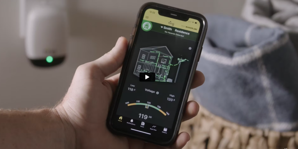

Ting’s plug-in sensor monitors home electrical systems to detect and prevent hazardous arcs and sparks before fires start. (Image: Whisker Labs)
Ting provides real-time monitoring and a history packaged in an app on my phone. Looking at the history, the voltage plot was variable but consistently within range, both high and low. I didn’t know what it should look like, but being in range made me think it was okay. I called the utility again. Again, the crew did their tests and deemed everything good, this time more aggressively stating that I was wasting their time. Whisker Labs was having none of it. Insistent that I had an issue, they offered to pay for a certified electrician to check it out. He repeated all the tests I’d watched the utility do, again finding nothing. Before leaving, he said the last thing was to inspect the overhead line visually. With binoculars in hand, we walked from the termination at the house toward the power pole on the street. We didn’t need the binoculars. Close to the street, there was an obvious break in the neutral line. It was completely severed, the ends dangling over a foot apart. My house had a very dangerous floating neutral, exactly what Whisker Labs detected.
