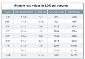

There is a correlation between the improved holding values of an anchor with the size of its diameter. Generally, the larger the diameter of the anchor and the deeper the depth of the embedment, then the higher the holding value.

The wedge anchor: should only be used in solid concrete and never in brick or block. These anchors are offered in several diameters, including from 1/4 to 1-1/4-inch and lengths ranging from 1-3/4 to 12-inch.
Wedge anchors are available in zinc plated, hot-dipped galvanized, and stainless steel. These components typically come complete with nut and washer, and provide excellent holding values in concrete.

- Tighten the nut three or four revolutions to set the wedge anchor. Torque values are typically found on the manufacturer’s manual or technical information page.
