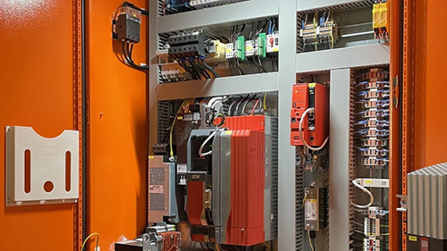

Figure 1: Inverter technology from SEW-EURODRIVE for a cold storage facility.

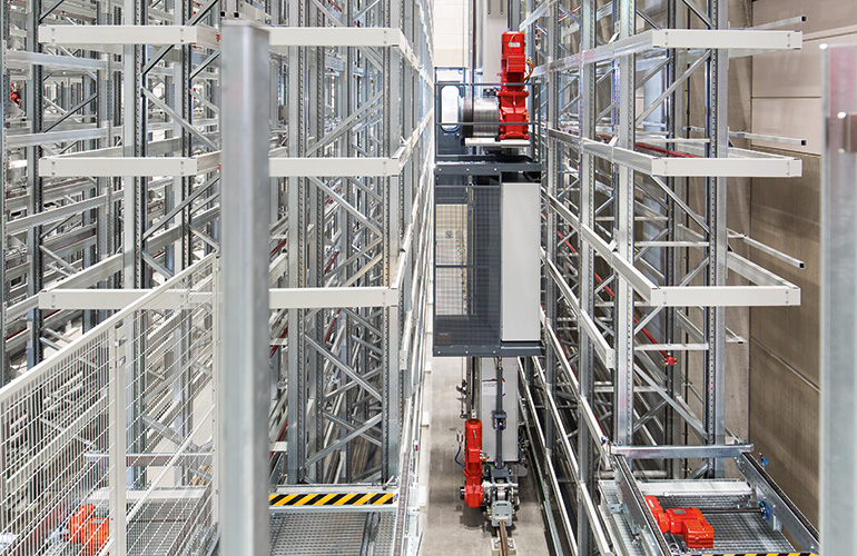

Figure 2: Reducing the peak power in an automated lifting.
