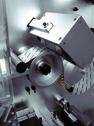

The term “flying shear” refers to general applications where the work performed by some type of tooling must be done on a moving target. At the beginning of a machine cycle, the tooling must reach a synchronized position on the moving target and track this position while the work is performed. Common flying shear applications include cutting, printing, and embossing a moving web. An example is heat sealing two plastic webs together while the webs are moving, which is common in blister pack manufacturing.
flying-shear
This example starts with a web of plastic packaging material. Pockets are previously formed into the web and product placed into the pockets. Another web of material, traveling on top, will secure the product in the pockets. The product will be held in airtight chambers to preserve the quality of the product after both webs are sealed together. A heated platen is used to create the seal by pressing both webs together. The temperature of the platen, the amount of seal force, and the contact time determines the quality of the seal. This assumes that the pattern machined into the platen aligns with the corresponding pattern on the webs. It also assumes that the platen doesn’t move relative to the web during sealing.
The motion of the seal platen is important to the seal quality and is divided into three phases. The first is referred to as the synchronization phase. In this phase the seal platen starts from rest and ends moving at constant velocity with the platen speed and position matching that of the web. The platen must accelerate up to speed while at the same time move the appropriate distance in order to align itself with the pattern on the web. The second phase is the tracking phase because the platen must maintain its alignment with the web so it can contact and seal the web. The amount of time the platen must stay in this phase is determined by the required seal time. The last phase is the return phase where the platen decelerates to a stop then returns to its starting position. All three phases must occur within one machine cycle.
It helps to think of the web as segmented into lengths where each length represents one machine cycle and typically one group of product. A group of product here is referred to as a blister pack. It can also represent multiple blister packs depending on the width of the web. The seal platen needs to know where the blister packs are so it can move the appropriate distance during the synchronization phase. This dictates that the web must be registered, which means that the position of the web is synchronized with the position of the nip roller. Most webs are pulled through the machine using nip rollers and the position of these rollers is used to report the position of the web. The length of web representing one machine cycle can be indicated as a nip roller position from 0 to 360 degrees. The web is registered to the nip rollers either through setup procedures, registration correction moves, or by the die-set that forms the pockets in the web.
