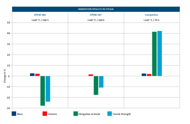

When comparing the new materials, tested at 160°C, to a competitor’s China-compliant material tested at only 140°C, the results are even more impressive. Despite the competitive materials exposure to a 20 °C lower temperature, the new compounds outperformed the competitive material with smaller changes in key performance measures. (See figure 3).
Freeudenberg-Steam
(Fig 3.) Even if the competitor’s material was tested at 20 °C lower temperature, the new Freudenberg compound’s results show smaller changes.
