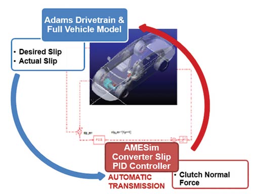

MSC-Software2
This graphic shows the Adams and AMESim FMI co-simulation process at Ford.

Ford wanted to simulate the effects of different torque converter designs so engineers could make calculated tradeoffs between slip and lockup before the prototyping stage. The solution came through a combination of simulation and modeling technology and an open standard for co-simulation called Functional Mock-Up Interface (FMI).
FMI enables engineers to create a virtual product from a set of models of physical laws and control systems. It also enables model exchange and co-simulation between different simulation applications. Ford used FMI to combine simulations of a slip controller, a drivetrain and a full vehicle into a single simulation that enabled engineers to accurately anticipate how clutch slip settings would affect fuel economy and NVH.
Ford created detailed 3D models of the drivetrain and the entire vehicle in MSC Software’s Adams multi-body dynamics software. The drivetrain model included a turbocharged gasoline engine, a torque converter with a lockup clutch, a six-speed gearbox, and a front driveline with differential shafts, constant velocity joints and wheels.
MSC-Software3
The vehicle model included the chassis, suspension, steering, brake and wheel sub-systems. Ford engineers also created a separate 1D model of the torque converter with AMESim multi-domain simulation software. Both applications support the FMI standard, which enables their models to work together in one simulation.
The engineering staff ran the model for different values of desired slip. The AMESim model, working as the FMI co-simulation slave, simulated the force on the lockup clutch. The MSC Adams models, working as the FMI co-simulation master, simulated how much NVH different slip settings would create in the rest of the vehicle.
Simulation results showed that a slip of 30 rpm would fail to meet the NVH target while a slip of 40 rpm or greater would meet the target. The simulation demonstrated that 40 rpm slip was the optimal trade-off between NVH and fuel economy. Engineers also studied related assemblies to gauge the effects of slipping on passenger comfort. They compared vibration at the steering wheel and seat track at no slip and 40 rpm (the slip setting) and found a substantial improvement in NVH that justified slipping the clutch to 40 rpm.
