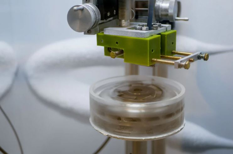

Simonetti recently published a novel approach that uses ultrasound to inspect additive-manufactured parts: He dips the part in water and freezes it inside a cylinder of ice. The ice acts as a coupling medium, letting ultrasonic waves enter and reflect against the part’s potential defects.

Simonetti freezes the metal part in a cylinder of ice and then sends ultrasonic waves through it. Since the physical properties of ice are very similar to those of the metal part, the waves easily pass through the ice and encased metal and pick up any defects in the part. When he’s done, the ice simply melts.

For ice to act as an effective coupling medium, it has to be crystal clear — If any cracks or bubbles exist, ultrasound waves will reflect off of the defects in the ice rather than the defects in the part.
But ice isn’t crystal clear. It’s cloudy and fractured. Send an ultrasound wave through it and the wave bounces in 15 directions. It’s even worse for bigger blocks of ice, like those needed to encase some of these metal parts.
Simonetti needed to find a way to freeze ice around the part while keeping the ice transparent. That meant getting a special machine that froze ice without causing bubbles or cracks.
“Of course, we had to build this thing,” he says.
A science kitchen set
Simonetti made this custom ice machine by hand, combining things bought on Amazon like baking pans, griddles and spindles. It’s like a science kitchen set, but it does the job. That job is to tackle the two obstacles that prevent the formation crystal-clear ice: cracks and bubbles.
Cracks form because water expands as it solidifies. Water freezes from the outside, forming a solid ice shell with liquid core. As the core solidifies, it tends to expand against the shell, which causes a buildup of internal forces that leads to cracking.
To prevent this cracking, Simonetti has made a cylinder with a metal base and plastic sides. Simonetti puts the metal part he’s inspecting inside of the cylinder and fills it with water. He then chills the metal base, which causes the water to freeze from bottom to top. The water eventually solidifies around the metal part and expands to the open top of a cylinder, rather than the sides.
Bubbles are little trickier. Dissolved air exists in water. As water freezes, it expels the excess air. This excess air accumulates on the freeze front, or where the water is turning to ice, to form bubbles.
“In order to prevent this phenomenon, you need to simply reduce the concentration of air on top of the freeze front. To do that, we stir the water to have constant flow,” says Simonetti.
To create this constant flow, Simonetti uses a spindle. By keeping the water in motion, the excess air never accumulates and the bubbles never form.
The result is a metal part encased by a block of crystal-clear ice, rivaling even the clearest ice sculpture. Simonetti can send ultrasonic waves unimpeded through this block to measure the safety of a metal part. When he’s done, he simply puts the part under water and the ice melts right off.
