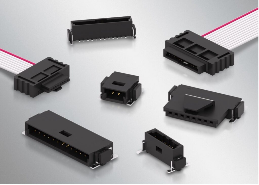

We can see this from companies developing leading-edge connectors for extreme environments. For example, some modern industrial connectors now integrate features such as shrouded pins, secure latching mechanisms, and SMT hold-down tabs. These were once the preserve of high-reliability connectors. Still, the cost of manufacturing these designs has decreased with each generational advance. It can now be integrated into lower-cost industrial connectors, providing a stable connection even in high-vibration environments.
Figure 1:  Examples of connectors designed to withstand high vibrational stress, with components tested to 20G for 12 hours and rated for up to 500 mating cycles.
