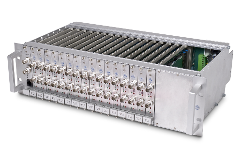

CHARLOTTESVILLE, VA — GE Fanuc Intelligent Platforms announces the DSC-2300 Series high performance signal conditioning systems. Developed to satisfy the growing customer requirement for powerful, modular signal conditioning solutions that are programmable and network-centric, the DSC-2300 is housed in a compact 3U, 16-slot rack-mountable chassis. With a smart Ethernet-based controller to allow for integration within any data acquisition environment, the programmable DSC-2300 Series is designed for a broad range of testing applications including jet and rocket engine testing, vibration testing, acoustic chamber monitoring, wind tunnel testing and other challenging applications requiring high performance.
The DSC-2300 Series achieves its significant performance benefits through its ability to process the input from a wide range of sensors, supporting up to 32 sensor channels (2 channels per slot). Its high channel density keeps its cost per channel low, while its 3U form factor makes it compact and capable of being deployed in space-constrained environments. Ease of use is facilitated by many built-in features such as network programmability, auto zero and balance, calibration, a plug-in mezzanine filter board for each channel and easy customization using the supplied programmer’s interface.
The DSC-2300 Series currently supports four plug-in signal conditioning modules that are fully configurable and programmable for gain, filter, cut-off frequencies, and calibration. The DSC-2320 module is designed for static strain applications, and provides a two-channel voltage excitation bridge amplifier. The DSC-2325 module is used for dynamic strain applications, and features a two-channel current excitation bridge amplifier. The DSC-2330/31 module supports charge/ICP‚â„¢ and voltage inputs.
