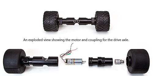

motor-and-coupling-exploded-view

Key to the LBC’s performance is the drivetrain. Four primary criteria (speed, pull force, size, and weight) helped guide motor selection and specifications. The goal was to make the LBC capable of travel at a relatively fast pace and deliver sufficient pull force for the tether while minimizing the size and weight of the motors in the overall assembly.
By developing 360 oz-in. of torque at 40 rpm, the Pittman gearmotors can drive the LBC at speeds up to 30 m/min (100 ft/min), which allows for underwater inspections to be performed quickly, especially important in situations where time may be critical. The 25 kg pull force easily handles the tether cable, ensures that wheels do not stall if drag conditions develop, and assists in overcoming strong water currents. The specified gear ratio is 84:1 and is consistent with the LBC’s speed/torque requirements.
A relatively small design envelope for the motors meant that size certainly mattered. Motor size was dictated by the layout of the axle, which houses the motors and drive electronics. So despite a tight fit, engineers were able to ensure adequate thermal management for the motors and motor controllers. The unit is cooled through conduction through the housing to the seawater. The resulting package is both compact and efficient. A specially engineered aluminum cylindrical housing performs multiple functions by supporting the wheels, serving as the axle, and snugly incorporating the motors (each approximately 5-in. long) and electronics.
Motor weight was an important consideration as well because any weight added to the vehicle would translate into a need for additional floatation to compensate and maintain buoyancy. Each of the gearmotors weighs about 2 lb. The weight and balance calculations were made to confirm that there would be neutral buoyancy and that the vehicle would be stable while maneuvering.
Even the wheels of the LBC are designed as buoyant elements. They integrate a light aluminum hub in the center of each wheel and are surrounded by a light polyurethane foam wheel. The tire is actually more like a rubber band stretched over the polyurethane wheel to provide a durable, high-friction surface.
The drivetrain design for the LBC involved a fair amount of customization. Examples of motor customization include a specially designed output shaft and front mounting configuration and the integration of optical encoders.

The motor’s output shaft was specified, in part, to fit a flexible coupling, which joins the shaft with a special shaft adapter to mitigate potential misalignment between shaft and adapter. The shaft adapter, which can withstand extreme abuse in service, was fabricated from 316 Series stainless steel and designed to fit, seal to, and lock into the hub of the wheel.
The motor’s front mounting configuration (round instead of the standard square design) conforms to the round housing to achieve a tight fit and provide a low thermal resistance path through the housing wall to the seawater. Custom mounting holes, which were a mechanical layout requirement, fit better and made assembly simpler.
Optical encoders were specified for the rear shafts of both motors that drive the front wheels. Their functions include measuring and displaying distance and speed of travel, and, as was the case with the flexible coupling, the motor’s shaft was specified to fit the encoder, not the other way around.
