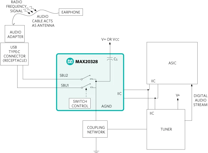

It is also possible to add an FM radio-antenna path to smartphones with USB Type-C Interface, using an IC such as the Maxim (now Analog Devices) MAX20328 MUX Switch for USB Type-C Audio Adapter Accessories. This IC, when properly managed, can provide the needed interconnection (Figure 5).
A full explanation of the operation of this topology and why it provides an FM antenna to a smartphone that has the processing power to decode the signal is provided in Maxim/ADI Application Note 6166, (see Reference). The lengthy note includes full design-in details, component-value analysis, and performance-test results.
