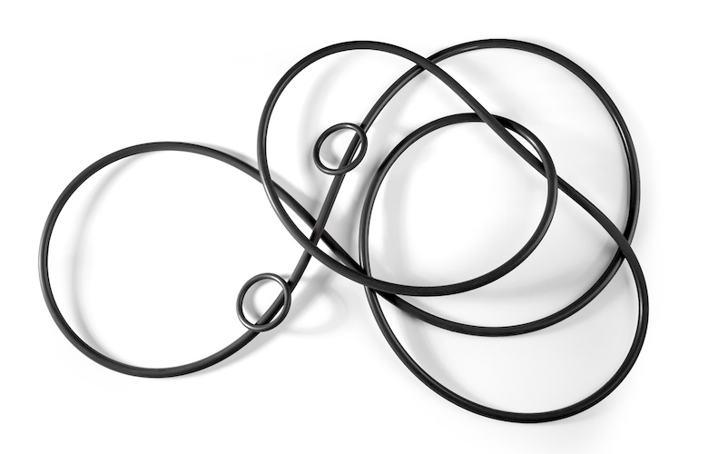

Greene Tweed has released results from a study confirming the compatibility of its fluorine-based elastomer seals with Sustainable Aviation Fuels (SAFs). The results provide critical insights for aerospace leaders transitioning to sustainable, low-emission fuels, while ensuring safety and reliability.
Fluoroelastomers are essential in applications requiring seals, gaskets, and components that must withstand harsh chemical and thermal environments. Image: Greene Tweed

Greene Tweed collaborated with multiple suppliers to evaluate SAF blends and their effects on the physical properties of fluorine-based elastomers FKM and FVMQ. The study assessed performance in SAF blends, including Synthetic Paraffinic Kerosene (SPK) and Synthetic Aromatic Kerosene (SAK), following ASTM D7566 standards. Testing simulated extreme aerospace environments, including temperatures up to 120° C and prolonged SAF exposure.
Key findings from the study include:
  • FKM compounds (731, 772, 665) maintained performance across blends, including three SPKs, 50/50 blends with control fluid, and 20% SAK with 80% SPKs.
  • FKM elastomers showed strong compatibility with harsh SAF conditions, including fluid aging and dry-out scenarios.
  • Aromatic content in SAF formulations, particularly SAK blends, is critical for maintaining material performance.
  • Testing under accelerated aging conditions confirmed long-term reliability.
