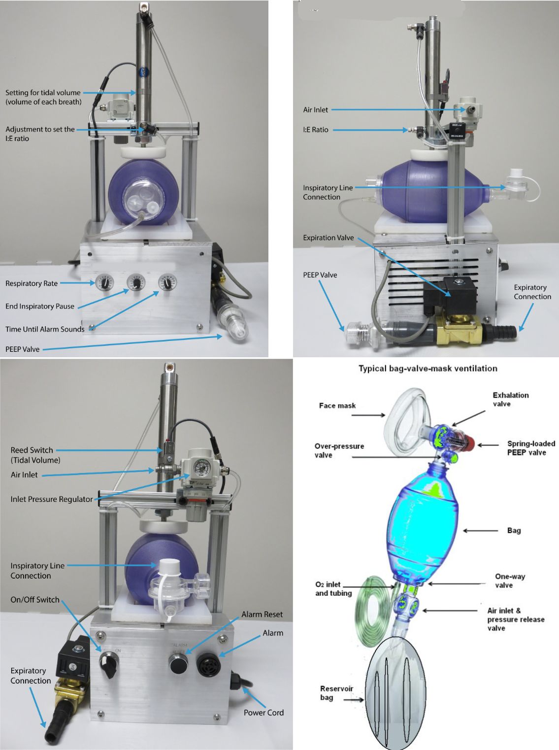

secondbreath
Views of the electric pneumatic resuscitator devised by SecondBreath, so named because it uses a pneumatic cylinder powered from hospital compressed air to depress the bag. It is clear from a comparison with an ordinary bag resuscitator that the process of converting these devices to respirators involves more than just adding a mechanical arm. The SecondBreath device, for example, includes alarms, controls, and regulators not found on bag resuscitators, all needed to meet ARDS Net compliance. Click image to enlarge.
Officials involved with obtaining FDA approval of the Cleveland-based effort, called SecondBreath, describe a process where device developers ran their own tests, then sent the result to the FDA for review. SecondBreath spokesman Windsor Ford says the firm’s interactions with the FDA were mainly through email. No FDA personnel inspected the manufacturing facility which consists of unused space in a Dan T. Moore warehouse. And no FDA personnel supervised testing. Nevertheless, there was “an enormous amount of testing” involved in proving the modified resuscitators complied with FDA requirements, says Ford. Some of this testing took place on a breathing simulator called an ASL 5000 which can “breath” while hooked up to a ventilator. The SecondBreath device also had to go through ARDS Net (Acute Respiratory Distress Syndrome) compliance testing which took place in cooperation with local hospitals. “We provided the FDA with extensive video and other documentation of our tests that made them comfortable that we had performed all the tests correctly,” says Ford.
