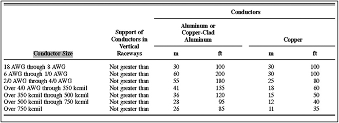

The National Electric Code (NEC) calls out specific installation methods for long vertical runs. NEC Article 300.19 (Supporting conductors in vertical raceways) states that cable support is needed at the top of a long raceway, with intermediate supports installed at specified lengths according to a formula based on the size of the wire, some as frequently as every 40 ft, as seen in the accompanying chart.
Let’s look at an example. In a 10-story building with conduit runs from the basement to the top floor with raceway containing 4/0 copper conductors, the unsupported copper cable length cannot exceed 80 ft. The heavier the wire, the shorter the unsupported cable length.
