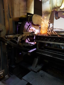

plasma-cutter-high-res
The time saving using the HDRT and plasma cutter system is therefore about 60 to 70%, if the tube length, diameter, and wall thickness are the same.

Historically, the cutting of the casings was done using two bandsaws. For this, the supplied tubes were cut into casings of the required lengths with vertical cuts (perpendicular to the tube axis). This was a lengthy process taking up to five minutes per cut. Eurocylinder Systems wanted to optimize this complex process. In 2009, the bandsaws were replaced by a plasma cutting machine. The cutting head of the plasma system has two plasma torches. They are placed opposite each other and rotate during the cutting process on a circular path 180° around the steel tube. One cutting head is responsible for the upper half of the pipe, the other for the lower half of the pipe. Eurocylinder Systems needed to ensure reliable, low-maintenance guided motion of these critical cutting head elements.

Plasma-cutting-heads
