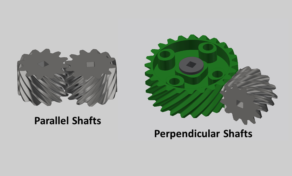

Besides smoother motion, higher speed capability, and less noise, another advantage that helical gears provide over spur gears is the ability to be used with either parallel or non-parallel (crossed) shafts. Helical gears with parallel shafts require the same helix angle, but opposite hands (i.e. right-handed teeth vs. left-handed teeth).
When crossed helical gears are used, they can be of either the same or opposite hands. If the gears have the same hands, the sum of the helix angles should equal the angle between the shafts. The most common example of this are crossed helical gears with perpendicular (i.e. 90 degree) shafts. Both gears have the same hand, and the sum of their helix angles equals 90 degrees. For configurations with opposite hands, the difference between helix angles should equal the angle between the shafts. Crossed helical gears provide flexibility in design, but the contact between teeth is closer to point contact than line contact, so they have lower force capabilities than parallel shaft designs.
