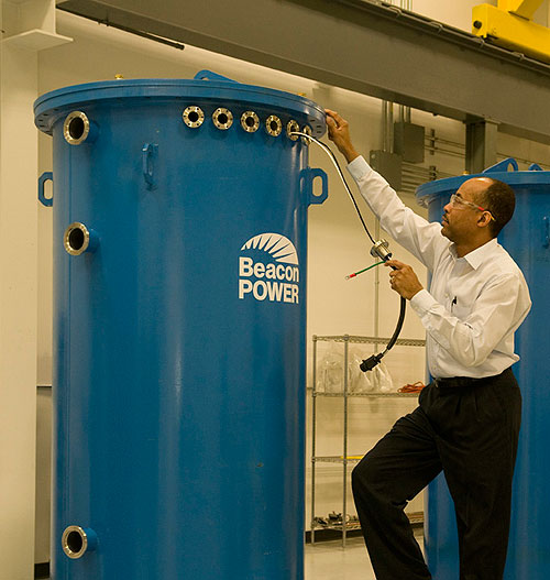

Signaling control feed through is being installed in a Beacon Power Smart Energy 25 flywheel.

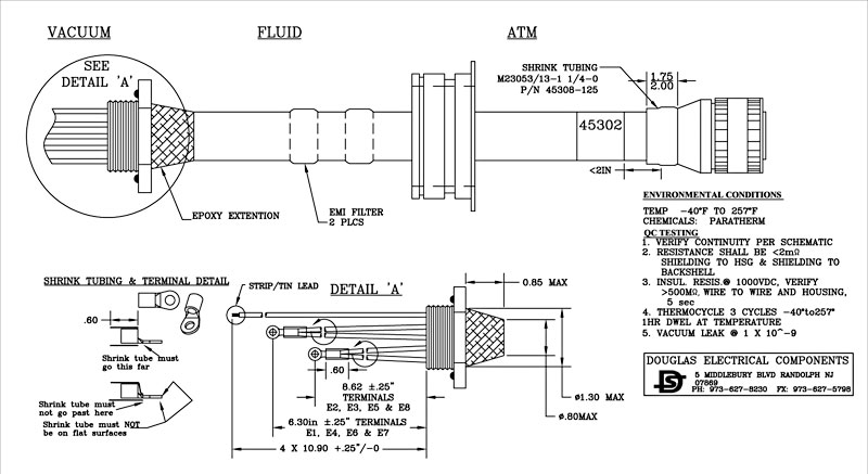

However, there are some challenging issues for FES designers. For instance, they must ensure the vacuum integrity of the flywheel housing while meeting requirements for noise-free monitoring and high power I/O. A breach in the rotor vacuum environment could lead to FES failure. As a result, making hermetically sealed feed throughs is an important step for FES development. When FES designers reduce system size, they should consider the co-location of associated electronic and control systems and how the essential feed throughs will be successfully situated. Thus, control and power feed throughs that fit into tight areas, turn corners, and maintain vacuum, require custom housing designs with special geometries and materials.
Tyngsborogh, Mass-based Beacon Power uses hermetic vacuum feed throughs to improve the performance of its Smart Energy 25 FES systems used on the utility grid to provide frequency regulation. The feed throughs transfer power and signal data from the control system on the atmospheric side to the internal volume of the vacuum-sealed flywheel chamber.
Control systems’ speed, temperature, and vibration need constant monitoring using numerous thermistors and sensors. Often, these devices require shielded or twisted wires to maintain signal integrity. For power transfer, copper post studs or heavy gauge wire feed throughs must be
accommodated, depending on current requirements. In all cases, small and high density feed throughs provide less risk of leakage than multiple connectors. Flywheel chambers that are submerged in a heat transfer fluid must be leak-proof and resistant to whatever fluid is in use.
Material selection is important for the vacuum environment and heat transfer fluids. Understanding parameters such as outgassing, permeability, and material compatibility can be critical in developing systems that will perform efficiently for more than 20 years.
