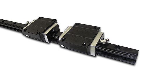

The Precision Alliance's Linear Rail Systems are designed for high temperature applications that require performance at temperatures up to 250oC. The linear rail bearing components are made from bearing grade steel with all other internal components made from high temperature metals. There are no plastic components.
The systems are available with Raydent or Thin Dense Nickel Chrome corrosion resistant plating on all bearing surfaces. The internal components are pre-lubricated with high temperature grease that won’t “drip” as the temperature rises.
With a product range that spans from size 15 to 65 we can directly interchange with most linear rail systems that are on the market
