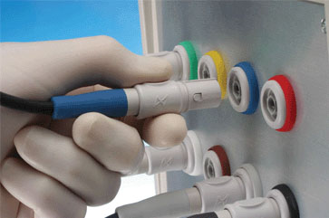

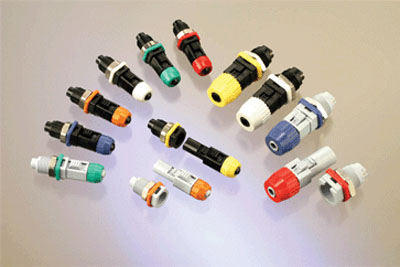

Designed specifically for the medical industry, HyperGrip from Hypertronics is a user-configurable circular connector; it is color-coded and customer-keyable for accurate and quick connections on medical equipment. This unique keying system allows customers greater freedom and diversity to build connectors with six different keying options from a set of common components, thereby reducing cost, lead-time and inventory. HyperGrip also incorporates the performance of Hypertac contact technology, which provide up to 100,000 mating cycles, low contact resistance, immunity to high shock & vibration, low force, and higher current carrying capacity.
To avoid the risk of cross-infections, the medical industry is more and more using disposable materials. The new Limited Use Connector from Fischer Connectors is directly mounted into a disposable handpiece, overmolded or mounted to a disposable cable. Mateable with all high performance panel and cable receptacles, the new Fischer disposable plug allows permanent equipment to keep working with high-cycle lifetime receptacles (more than 5,000 mating cycles).
