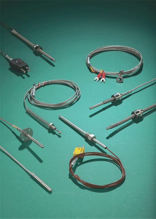

Thermocouples come either protected or not. One type has simple, fabric covered leads with the element exposed and unprotected so it can directly contact the surface to be measured. The other type is embedded in a variety of protective sheaths. However, the protection is a mass that displaces the measured temperature from the actual temperature, stretches out the time constant, and requires more time for the sensor to respond to temperature changes.
Thermocouples
Thermocouples are the smallest, fastest, and most durable of temperature measurement devices. They can withstand extremely high temperatures and harsh mechanical punishment, and they are simple to operate. Because they are so small, they respond rapidly to temperature changes, and their sensing junction can be placed close to the measurement point. The durability and simplicity of this sensor type make it ideal for embedding into other devices.

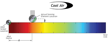

Temperature measurement errors arise from several sources, which include location, transients, and heat transfer. Often, it is difficult to sense the temperature at the exact point where it is needed because the sensor has a finite size or is surrounded by an encasement that displaces the sensing element. Then the sensor’s actual temperature will be different from that at the intended measurement point. However, such location errors can be compensated when surrounding heat sources and sinks are known. A simple solution, which avoids complex calibration techniques, uses the smallest sensor possible, placed as close to the temperature source as possible. Thermistors and RTDs have larger errors than thermocouples located in the same place, due to their larger size.

All three types of sensors can be custom made and packaged for specific applications to deliver exceptionally accurate and repeatable temperature measurements. One interesting configuration is the eyelet lug that looks like a ground strap but contains a temperature-sensing element.

When measuring temperature on a surface, forced airflow on and around a sensor can contribute to a false reading because of heat-transfer error. Convective currents add or remove heat from the sensor and measurement surface. When the atmosphere and surface temperatures differ, or the measurement environment is moist, convective heat flow must be considered as if it were another heat source or sink.
Frequently, temperature sensors cannot be located at the ideal sensing spot. It may be displaced because of the sheath in which it resides, dimension B, or it simply cannot be moved closer than dimension A because of some other physical limitation of the device under test.
