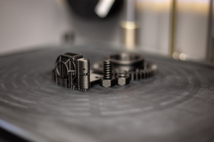

Additive manufacturing offers a streamlined and efficient method of printing many different parts, which can lead to simplified supply chains. These fasteners were printed in nylon and carbon fiber.
