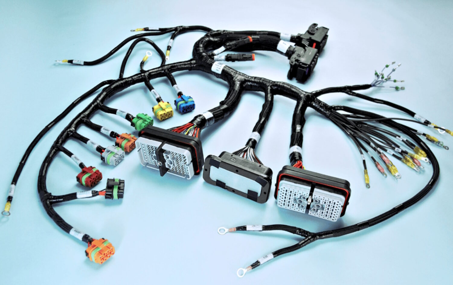

Wiring harnesses, sometimes called cable assemblies or cable looms, are used in every corner of the electronics industry, including consumer appliances, commercial devices, robotics and industrial systems, computers and servers, telecommunications equipment, medical systems, aerospace platforms, and of course, trucks and automobiles. However, the wiring harnesses used in electric vehicles (EVs) are among the most complex and demanding.
That can be somewhat surprising since the drive train components in an electric vehicle (EV) are more straightforward than those of an internal combustion engine (ICE) vehicle. Two factors contributing to the complexity of EV wiring harnesses are the use of high voltages in the drive train and the fact that all controls in an EV are communicated through the harness; there are no hydraulic or mechanical linkages common in ICE vehicles.
