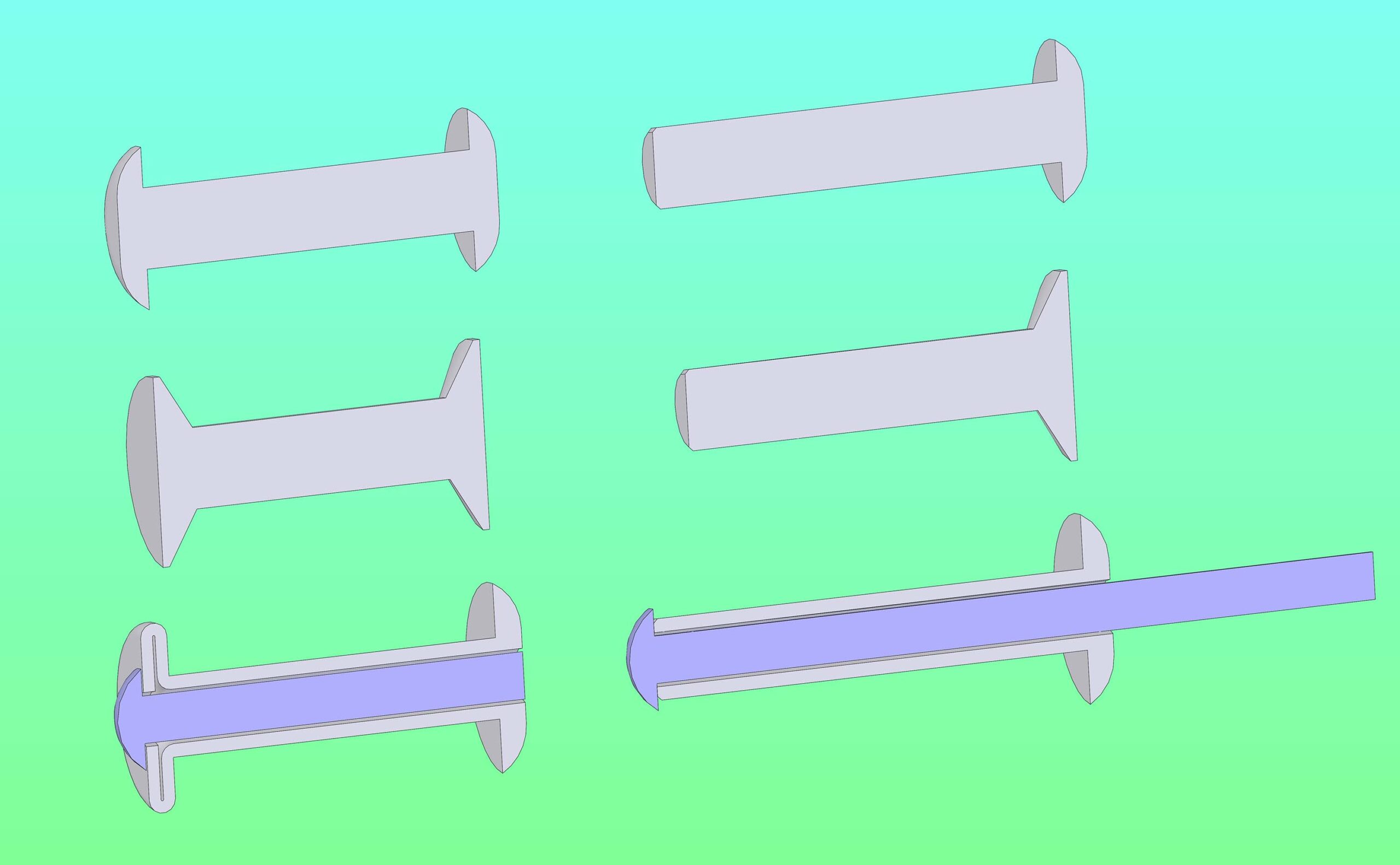

A selection of rivets, shown after installation on the left and as supplied on the right. From top to bottom: Solid rivet with universal head, solid rivet with countersunk head, and blind rivet.

Solid rivets
Solid rivets are one of the oldest, most popular and commonly used types of fasteners. They are highly safe and reliable fasteners, with proven effectiveness in critical applications. For these reasons, they are widely used in the construction of aircraft. In such cases, a form of hammer and anvil are required to form the factory head of a solid rivet. Both sides of the hole also require access for installation, so that the anvil is against one end of the rivet and the hammer strikes the other end. Hand hammers are rarely used for this process. Instead, modern manual riveting operations use hand-held air hammers.
Automated drilling and riveting machines are also typical in aerospace manufacturing. These incorporate hydraulic or electromagnetic presses. Semi-tubular rivets are solid over the main part of the shaft, which carries the shear load, but are hollow at the shop end to make it easier to form the shop head.
In construction industries, such as when joining steel structures for bridges or steel-framed buildings, solid rivets have largely been replaced by bolts. This is because rivets are more time-consuming to install and remove, offering limited clamp load.
Blind rivets
Blind rivets are hollow with a mandrel on a stem that runs through a central hole. By drawing the mandrel back through the rivet’s body, the factory head can be formed from the opposite side. This means it’s possible to install them from one side — or into a blind hole.
However, special-purpose riveting tools are required to install blind rivets. Manual tools are divided into plier-type riveters, which tend to be less costly and more compact, and lazy tong rivet tools. Lazy tongs are capable of installing strong rivets that require great force.
