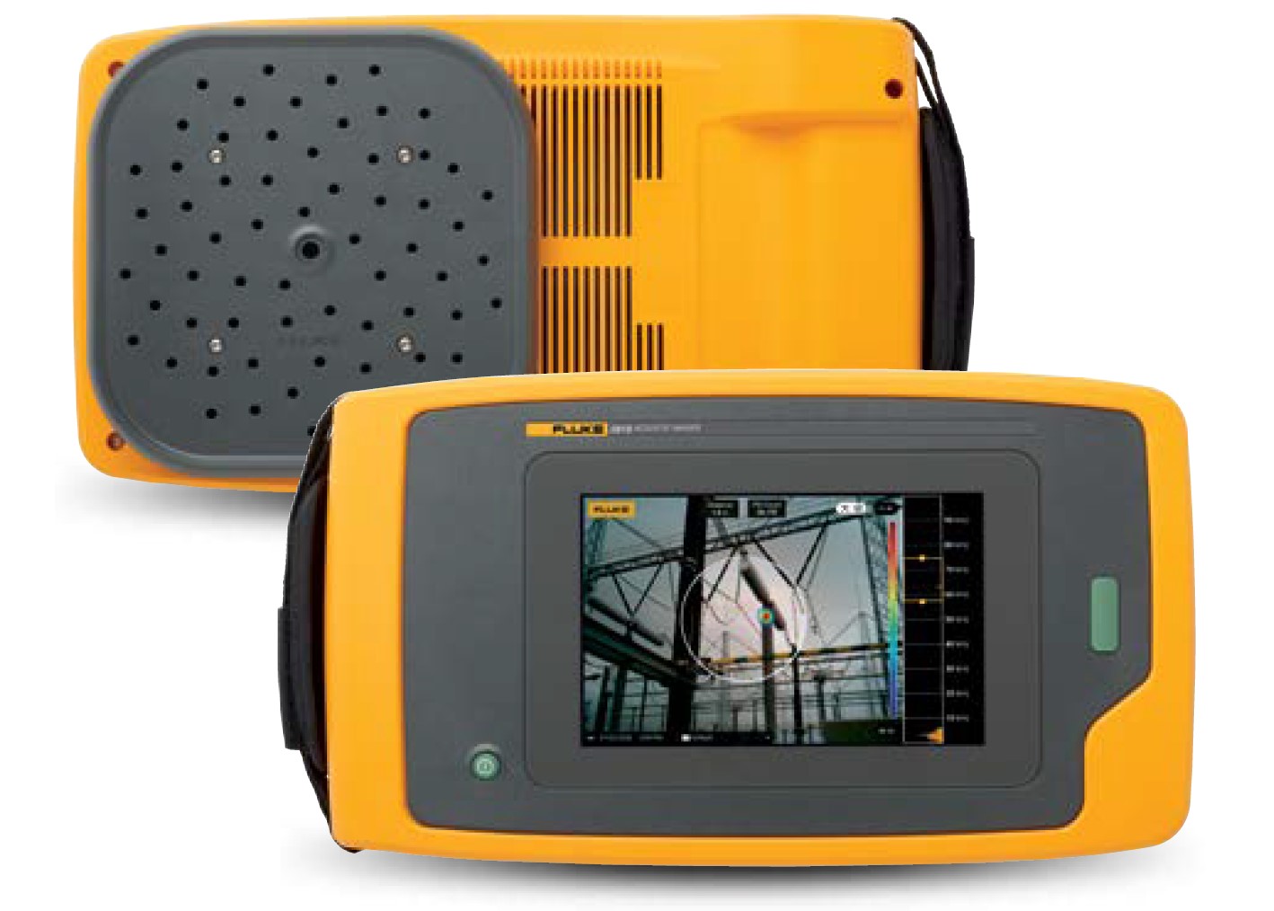

Point-and-shoot acoustic imagers
A handheld acoustic imager has been developed for applications like identifying leaks in compressed air, gas, steam, and vacuum systems and detecting and localizing partial discharge conditions in insulators, transformers, switch gears, or high voltage (HV) powerlines. The 64 microphones in the acoustic array operate from 2 to 100 kHz with a detection range of up to 120 meters. The array has a field of view of 63° ± 5° and takes images at a rate of 25 frames per second. The integrated digital camera has the same field of view plus a 3x digital zoom capability with a resolution of 5 megapixels. In addition to displaying still images, the system can take videos up to 5 minutes long (Figure 3). To minimize background noise interference, the imager automatically compensates for background noise and has multiple bandwidths that are selectable via manual inputs or with user-made presets.
