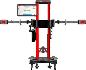

Target-based calibration, also called controlled environment or static calibration, uses targets with specific shapes and sizes at specified distances to calibrate ADAS sensor performance in a static setting.
Static ADAS calibration requires specific lighting conditions and the absence of reflective surfaces to avoid sensor confusion. Calibration targets are used to calibrate and align the sensors (Figure 1).
Figure 1. Typical target-based ADAS calibration system. (Image: John Bean)
The highly controlled conditions for target-based ADAS calibration support high-accuracy calibrations. However, the use of a controlled environment is also a limitation, as ADAS is often operated in uncontrolled environments on roadways. As a result, target-based ADAS calibration is generally used in combination with targetless calibration.
