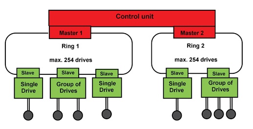

One of the most obvious differences is that version II uses fiber optics as its physical layer while version III uses Industrial Ethernet. Both use a ring configuration, with straightforward installation. Patch or crossover cables connect nodes.
The unidirectional nature of fiber optics requires that version II be a single ring. However, in version III the full duplex capability of the physical Ethernet structure is used to achieve redundant data transfer based on a double ring topology (logical, not physical) rather than a single ring. Communications are not interrupted if there is a cable fault or node failure anywhere in the ring. An integrated diagnostic function can identify the defective cable link or node, which can then be repaired without affecting machine availability. A linear topology can also be used in version III. This doesn’t offer the redundancy advantage, but does eliminate one cable for cost savings.
Sercos II connects up to 254 devices to
a control using a single ring; Sercos III connects up to 510 devices. A
control system may have multiple rings, each ring consisting of one
master and multiple daisy-chained slaves.

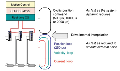

Operating Modes: Both versions use intelligent drives, where axis-dependent control functions, such as loop closures, interpolation and registration, are placed in the drives, not in the motion controller. In operation, the control issues a position command to the drive, which then closes its own loops and micro-interpolates its trajectory, based on previously downloaded parameters.
Version II is generally used only in these distributed drive applications, while version III also supports centralized signal processing where only the current loop is closed in the drive, and torque and position loops closed in the control. Thus, the control loops for multiple axes can be implemented in central electronics.

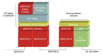

Safety:
Sercos safety features are based on a producer-consumer model supporting single and multi-cast connections. The features route data specific to safety across version III networks and directly to slave devices. Thus, this interface can be used within safety applications up to SIL 3 (Safety Integrity Level) according to IEC61508, even with the shortest cycle times. Version III provides one network for both standard and safe communication. Safety-relevant data are transferred along with real-time data and other standard Ethernet protocols on a single physical medium, without the need for a network between motion control and safety.
In November 2006, ODVA and Sercos International (SI) announced that SI will adopt the CIP Safety specification as its functional safety protocol. ODVA will extend this specification to include safety profiles for Sercos devices. SI will develop the network adaptation to utilize CIP Safety. SI and ODVA jointly will develop and establish conformance testing for devices implementing these protocols.

Sercos International (SI) will adopt
the ODVA CIP Safety specification as its functional safety protocol.
Sercos devices.
