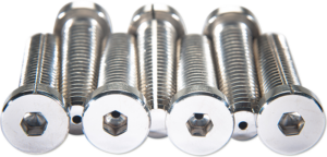

Vented screws feature a hollow core, which rapidly eliminates trapped air volumes from the base of the screw during pump-down when used within a vacuum system, ensuring a clean environment. Learn more in this video.

Vented screws (also known as vacuum, ventilation, or hollow screws) and/or vacuum baking are two methods that can address potential contamination issues.
A vented screw features a hollow core, which is specifically designed to allow the release of gases, contaminants, and pressure through the fastener. These types of screws are widely used within vacuum systems and allow for the quick evacuation of trapped pockets of air and surface contaminants from blind-tapped holes.
