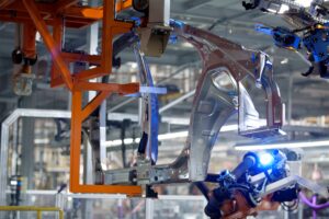

1. What are the key automotive applications for laser welding and why is it the best choice for these applications?
Within the automotive industry, there has been an increase in the use of laser welding in manufacturing. It’s now commonplace for many automotive applications, including the large-scale welding of body frames (body-in-white), door frames, trunks, auto hoods, and chassis, and laser plastic welding (for front and back lights, as well as electronic housings).
Laser welding is also widely used for metal welding of many sub-components, including airbag initiators, motor coil windings, battery tab-to-bus bar connections for vehicle electronics, and electrical interconnection within an automobile build.
Previously, welding for these applications have been done through a variety of other technologies, including resistance welding (RW), tungsten inert gas (TIG or GTAW), and metal inert gas (MIG or GMAW).
Lasers are now being used in several mobile welding applications because the process imparts less heat, resulting in more localized heat with a smaller heat-affected zone (HAZ). Additionally, with the industry moving toward lighter and more conductive material, it’s easier to weld with laser welding than, for example, resistance welding (RW). This is because laser welding imparts localized heat, meaning operators can address smaller parts. Better accessibility and fewer restrictions to parts enhance the design flexibility, enabling approaches that may not have been possible with other techniques.

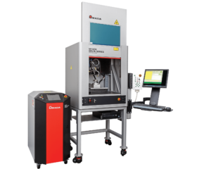

Tab-to-cell and tab-to-bus bar
Another growing market has been connections between battery cells, battery packs, and battery modules. As hybrids and fully electric vehicles continue to increase, the demand for this weld will continue to increase. AMADA WELD TECH has developed several solutions for joining the tab-to-cell and tab-to-bus bar.
The Delta Series laser welding systems offer flexible, lean-manufacturing-ready Class I environments for precision laser spot and laser seam welding.
As the industry has continued to develop, there has been a transition to more conductive material for the tabs. However, the battery material (if using cylindrical batteries) has not changed. We’re now frequently requested to weld Cu to cold-rolled steel (CRS) can, or even worse, aluminum to CRS.
New laser sources enable this dissimilar metal joining. For example, AMADA WELD TECH has used 500 W-1000 W single-mode continuous wave fiber laser micro welders to concentrate the energy into a small spot to aid energy coupling into the material and resultant penetration.
This new technique shows promise for joining dissimilar metals found in the tab-to-cell application. In one case study, mechanical testing found peel strength to be good – after thermal soak and shock, 50 samples of the weld peeled within ±2 N. This narrow band of peel results shows reproducibility and reliability needed in production. The high power allows for a better connection of thicker tabs to the bus-bar.
