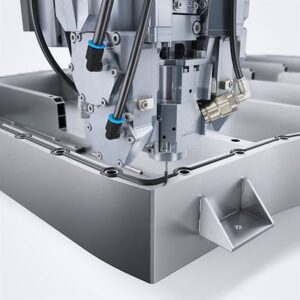

A precisely contoured double-seal application fastens the battery housing of an EV with polyurethane sealing foam Sonderhoff Fermapor K31.

The die-cast aluminum housings for holding the electric batteries are sealed efficiently, precisely, and securely using FIPFG (Formed-In-Place-Foam-Gasket) technology. The CNC-guided mixing head of the Sonderhoff mixing and dosing machine moves along the housing geometry and applies the two-component polyurethane sealing foam Sonderhoff Fermapor K31 with precise contours. After foaming, a seamless foam gasket is produced which cures at room temperature.
