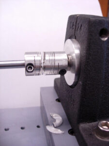

A beam coupling has failed near the center, representing what may occur in a torque-overload condition.

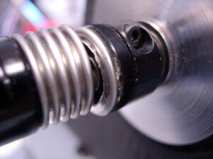

This bellows coupling has failed in a deep convolution that’s closer to one hub than the other, showcasing what might occur in a misalignment situation. This type of failure can occur when the degree of misalignment exceeds the coupling’s design limits, or when the coupling is improperly installed, and the misalignment is not uniformly distributed across the bellows.
