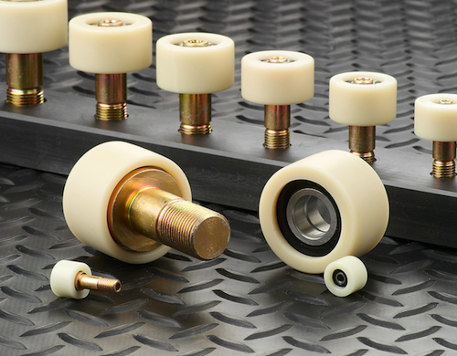

When selecting Intech iCamFollowers® the designer can eliminate most of the disadvantages of metal cam followers. This is especially the case in designs where the cam follower’s primary function is to transmit motion and not its high load carrying capacity.
Today the trend is toward high speed, light weight, and light duty machines in processing, packaging, medical, and semi-conductor machines, which account for about 40 percent of applications. In these applications, Intech iCamFollowers® can easily carry the load, help simplify design, and better achieve the design goal.
Considering the cost associated with design and operation of metal cam followers, it pays to better understand the actual load carried by the cam followers in the application. With load data, including radial and axial forces, load duty cycle, and desired linear speed, Intech engineers can use a unique plastic roller life calculation to quickly assess whether an iCamFollower can be used.
The load capacity of Intech standard iCamFollowers® is listed on Intech’s web site and represents the maximum load the cam followers can safely carry for 100 million cycles, under both static and dynamic loads, without developing a flat or excessive wear. A consultation with Intech engineers may lead to an alternative designs, opening the way to eliminating wear and lubrication as well as the number of modifications in the machine’s design.
