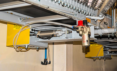

Figure 1. It is easy to focus on larger items for a pneumatic installation, and overlook smaller but crucial components. All figures courtesy of AutomationDirect.
This syndrome of overlooking details is also quite common for industrial pneumatics projects. Designers plan the system, determine pressure and flow requirements, select control components, and focus on larger items like cylinders, Figure 1. Yet often times, some smaller but crucial components are missed. While these parts may be available at a local distributor, many pneumatics components aren’t for sale at the hardware store down the street.

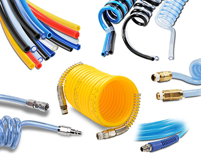

Flexible and durable tubing connects devices together by transporting compressed gas, usually air (but sometimes nitrogen), Figure 2. Most pneumatic systems use some amount of flexible tubing unless they are entirely hard-piped.
Figure 2. Pneumatic tubing is available in many sizes and colors.
Some designs may use just one size and color of tubing, making it easy to stock the right material. But many installations need multiple tubing sizes, and oftentimes it is helpful to use various colors to identify functionality. Special tubing for extreme temperatures or added flexibility may be needed. For these and other cases, getting the right materials on hand is more complicated.
Usually, the tubing is remembered with the initial material order because designers plan for what is needed. However, an installation often runs short because the necessary lengths were not calculated properly to account for twists, turns, and tough-to-reach locations.
When an installation runs short on tubing, a local supplier may have enough of the right size and color in stock to match the already completed work — but this is a gamble compared to ordering enough upfront. When it comes to tubing, it pays to standardize as much as possible, over-order to some extent, and work with a supplier offering a comprehensive product selection.

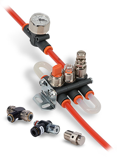

Fittings are used to connect tubing to devices or other sections of tubing, and they are typically threaded on one end and have push-to-connect or barb connections on the other, Figure 3. Because the fittings must accommodate various tubing and device sizes, many styles may be needed.
Careful planning is required to ensure the correct sizes are ordered. Outside diameter of the tubing determines push to connect size, while inside diameter determines the type barb style fitting. Threaded size is very important because there are different types:
• National pipe thread (NPT), tapered
• British standard pipe thread (BSPT), tapered R-thread
• British standard parallel pipe (BSPP), straight G-thread
• Metric versus United States (or British) sizes
Beyond the size, each fitting must be selected with the right materials of construction based on the environment and operating pressure. Stainless or thermoplastic are options for push to connect fittings. Barb style fittings are usually brass.
A missing or incorrectly sized or specified fitting can add days to a project schedule.

The term “specialty fitting” or “special purpose fitting” is a catch-all for any functions that may be less commonly used for an application, Figure 5. Some examples are:
• Small flow control restrictor valves, used to lower actuator speeds
• Check valves to allow airflow in only one direction
• Shuttle valves which shift to route the higher pressure from one of two inputs to the output
• Bleeder valves with manual pushbuttons to bleed pressure trapped in part of a system
These items are special in the sense that a designer may not typically use them, which is a good reason why they might be overlooked during design. However, many of these items can be difficult to source locally and should be carefully ordered in advance.
